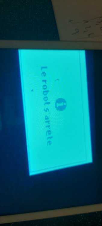

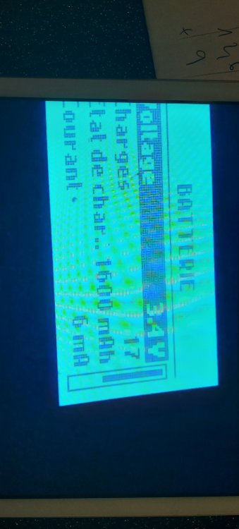

pierru Posted March 9, 2021 Author Report Share Posted March 9, 2021 Intensités mesurées pendant la charge 14mA Ça me paraît un peu faible ?... Lorsque j'arrive a regarder les infos batterie, je vois ceci Quote Link to comment Share on other sites More sharing options...
pierru Posted March 9, 2021 Author Report Share Posted March 9, 2021 Quelques secondes après je lis ceci: Quote Link to comment Share on other sites More sharing options...
pierru Posted March 9, 2021 Author Report Share Posted March 9, 2021 Puis: Quote Link to comment Share on other sites More sharing options...
pierru Posted March 9, 2021 Author Report Share Posted March 9, 2021 Et enfin Tout ceci en 10 secondes Quote Link to comment Share on other sites More sharing options...
