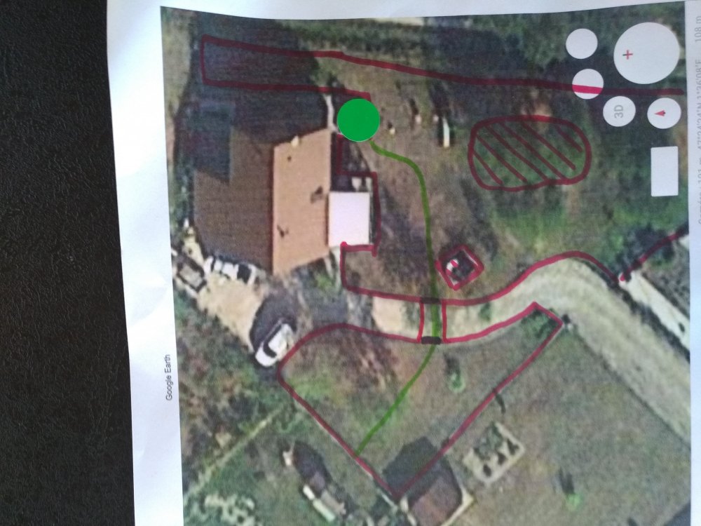

alexandre Posted March 26, 2020 Report Share Posted March 26, 2020 Voilà mon jardin vous pensez Quoi de mon implantation ? Après je ne sais pas si je fais un passage sur l aller où je le mes sur la 2 zone manuellement ? Quote Link to comment Share on other sites More sharing options...
Gautré Posted March 26, 2020 Report Share Posted March 26, 2020 Super Alexandre, pour moi je laisserais comme cela , avec le passage à travers l'allée. Bravo, cordialement hervé Quote Link to comment Share on other sites More sharing options...
Shark Posted March 28, 2020 Report Share Posted March 28, 2020 Bonjour, Je laisserai également le passage. Bye Quote Link to comment Share on other sites More sharing options...
Fred Posted March 28, 2020 Report Share Posted March 28, 2020 Idem Quote Merci aux Supporters de soutenir le forum Fonctionnement du forum Mon installation Link to comment Share on other sites More sharing options...
alexandre Posted March 29, 2020 Author Report Share Posted March 29, 2020 Aller tous et pré pour attaquer l'installation du fil !!! Fred 1 Quote Link to comment Share on other sites More sharing options...

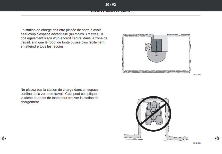

SteveL Posted March 29, 2020 Report Share Posted March 29, 2020 Étrange de ne pas respecter le guide rapide ou le guide d'installation pour le placement de la base........ L'installation commence mal........ Quote Link to comment Share on other sites More sharing options...
SteveL Posted March 29, 2020 Report Share Posted March 29, 2020 Quote Link to comment Share on other sites More sharing options...
alexandre Posted March 29, 2020 Author Report Share Posted March 29, 2020 Quand il et dans un abris c est la même situation Quote Link to comment Share on other sites More sharing options...
SteveL Posted March 29, 2020 Report Share Posted March 29, 2020 Non car l'abris est dans la zone de tonte. Quote Link to comment Share on other sites More sharing options...
alexandre Posted March 29, 2020 Author Report Share Posted March 29, 2020 On verra bien car j avais pas trop de solutions pour la place ! Je vais jouer avec le fil de guide Quote Link to comment Share on other sites More sharing options...
SteveL Posted March 29, 2020 Report Share Posted March 29, 2020 Bonne continuation......... Quote Link to comment Share on other sites More sharing options...
alexandre Posted March 29, 2020 Author Report Share Posted March 29, 2020 Ok bon je vais voir pour le faire passer sous les cailloux Quote Link to comment Share on other sites More sharing options...
SteveL Posted March 29, 2020 Report Share Posted March 29, 2020 Cela ne changera malheureusement rien car dans ce cas, le robot ira taper dans la planche qui tient vos cailloux vu que cela sera considéré comme la zone de travail .... Quote Link to comment Share on other sites More sharing options...
alexandre Posted March 29, 2020 Author Report Share Posted March 29, 2020 Bon y faut que je revoi sa Quote Link to comment Share on other sites More sharing options...

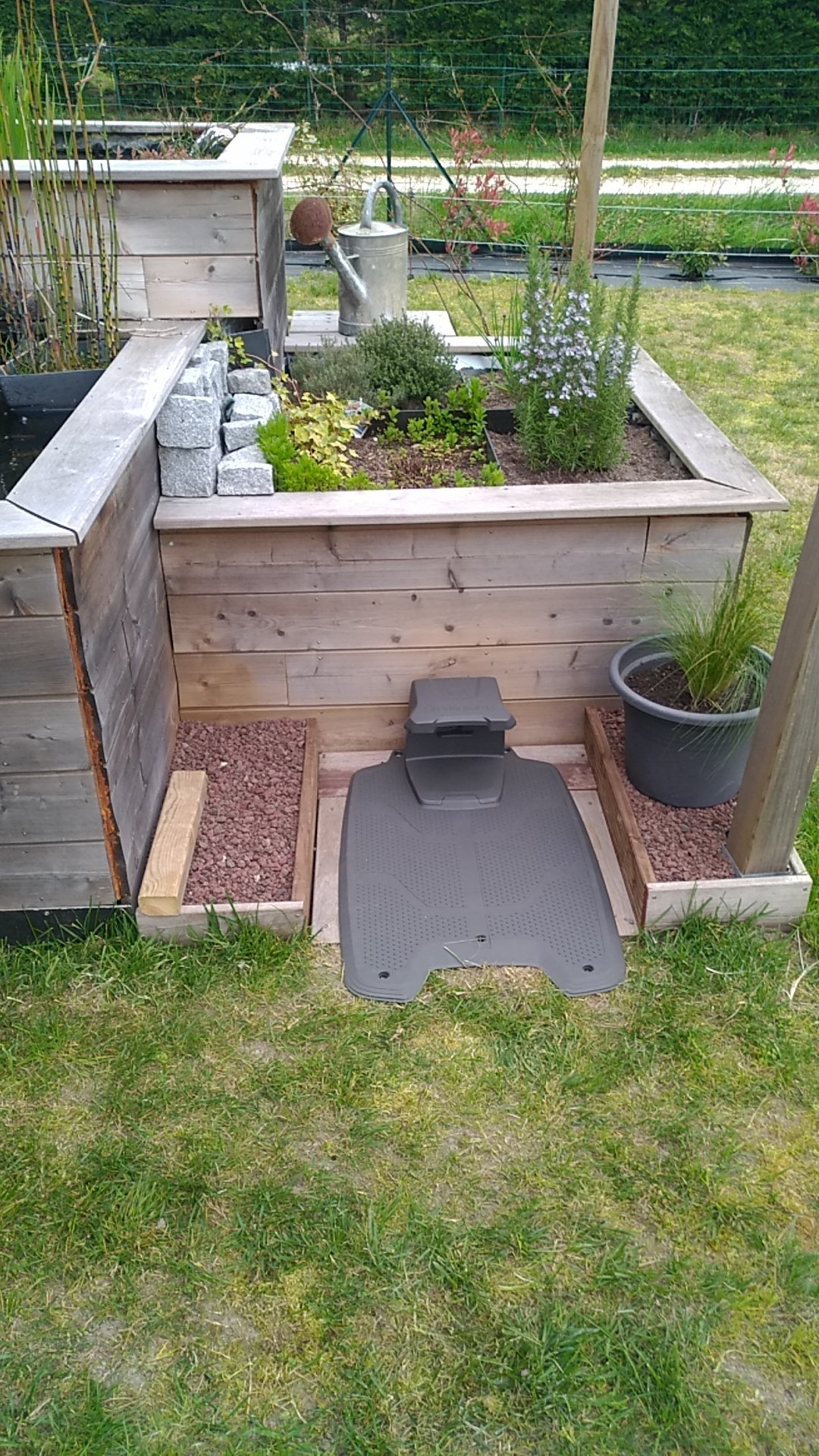

Gautré Posted March 29, 2020 Report Share Posted March 29, 2020 Bonjour Alexandre, pour moi, cela doit marcher. Si tu fais arriver tes câbles périphérique dans tes bacs , ça marchera. C'est ce que j'ai fait l'an dernier. Bien sûr , comme le dit Stevel, et il le montre bien sur le plan, ne pas arriver sur l'arrière. En ce qui me concerne, le robot est sous abri, et, cela le protège . Sur la photo, on peut voir dans les angles les fils périphérique arriver. Le robot bien à l'abri du soleil et de la pluie Bien cordialement Hervé Quote Link to comment Share on other sites More sharing options...

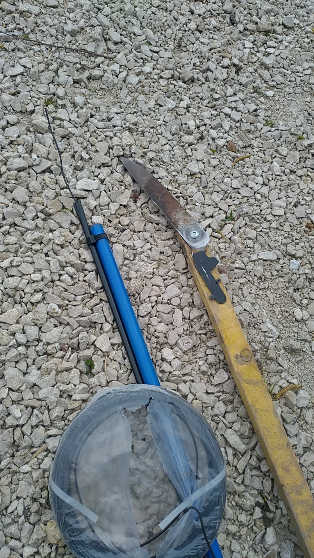

alexandre Posted March 30, 2020 Author Report Share Posted March 30, 2020 Aujourd'hui j ai commencé a enterrer mon fil bon la seule technique qui marche bien la bêche et les petits doigts pour enfoncer le fil !!! Quote Link to comment Share on other sites More sharing options...
